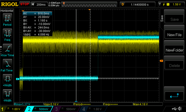

    You say that you could initially see a few mV on the SIM_1V8 pin when powering up the prototypes, but it only lasts for a short duration. It would indicate that the SIM_1V8 pin on the package is trying to start it up but there's a short and the regulator collapses.Did you capture this behavior on any tool?
    Yes, I have recorded it. The picture below shows the behaviour. The picture shows two different bords. The yellow line is the SiP power supply (3.3V), the blue line is the 1V8_SIM. About 1s after powering up, the 1.8V line spikes. In one case the voltage reaches 200 mV and in the second 6 mV, in both cases the spick duration is 244 ms.

  • Do you have any components between the SIM_1V8 pin on the SiP and the SIM card holder itself? Did you do any changes to the component selection between the two prototype runs?
    I assume on the first prototype run the SIM_1V8 line goes up all the way to 1.8V and the duration, 244ms, is the same?
  • This is the schematic corresponding to the SIM. The SIM bus is connected directly to the SiP. The U2 is the EMI filter for the SIM interface.
    This is the first working prototype. The yellow line is the SiP power supply (3.3V), the blue line is the 1V8_SIM. The 1.8V is always present.
