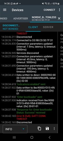

I'm trying to perform a device firmware update using the buttonless service on nRF52DK with SDK v17.1.0 and Softdevice S132.
I can connect correctly to my DK and I see the Buttonless DFU service on nRF Connect using my phone.
However, when i send the request to enter bootloader mode, I get a GATT CONN TIMEOUT error, my device disconnects and doesn't go into Bootloader mode. It doesn't even reset, because i can't see the device available on nRF Connect, i just have to manually reset it.
I don't have watchdog running and NRF_BL_WDT_MAX_SCHEDULER_LATENCY_MS is set to 60000 in my bootloader sdk:_config.h
Here's the error log:
Does anyone know why may this be happening?

    The connection timeout suggests that the phone did not receive the disconnect PDU from your device (sent from disconnect()). This can prevent the phone from re-connecting to the device in DFU mode, as it must wait for the 4 second supervision timer to expire. Did you get the connection timeout error when testing with the buttonless example as well? I was not able to spot any obvious errors in your implementation.

    I figured the problem was bootloader wouldn't start up when i don't do log_init(). I don't know why this happens, i removed every NRF_LOG and bootloader would run correctly, but if i remove the log_init() line it just doesn't start, why may this be happening? i can start bootloader mode manually (pressing button 4 while resetting) though.

    Glad you found the problem. Yes, using the LOG macros without initializing the logger module first can lead exception and asserts. You can disable logging by setting NRF_LOG_ENABLED to '0' in sdk_config.h. You don't need to remove the logger functions in your code.
