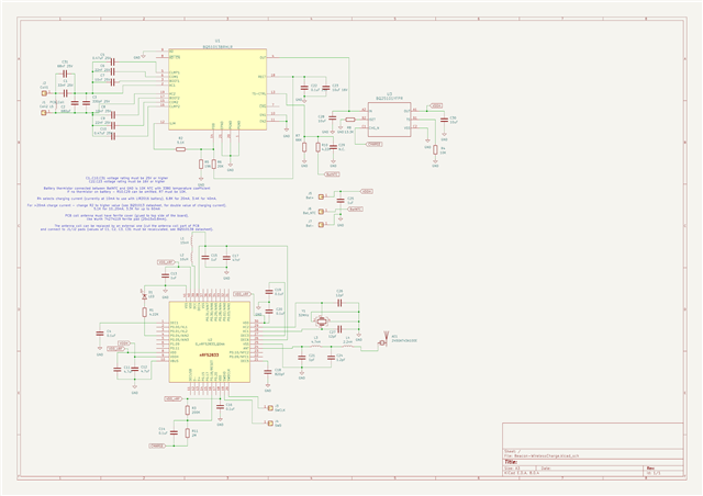

I'm trying to make a BLE beacon with Li-Ion battery and Qi wireless charging circuit. NRF52833 works in high-voltage mode (VDDH connected directly to the battery, internal LDO regulates VDD) There are a lot of problems with different charging ICs, so had to choose BQ25101Y chip which doesn't have battery over-discharge protection. My plan was to put NRF52833 into shutdown mode with sys_poweroff() when battery voltage is lower than 3.0V. But i've encountered weird problem.
When i call sys_poweroff() function in zephyr application at input battery voltage 3.7..4.2V, power consumption (measured with PPK2) is 0.6uA. But if i decrease input voltage below 3.6V - power consumption jumps to around 45uA at 3.5V (25uA at 2.1V). It doesn't change if i change REGOUT1 at all (stays same for internal LDO output at 1.8V or 3.3V).
This behaviour not unacceptable as in real device battery will have quite small capacity (20-50 mAh) and that consumption will over-discharge battery very fast. This is normal in high-voltage mode or i've screwed something? Below is full schematics for my beacon:
    Some comments on the schematic:
    You are missing a matching network for the antenna, you only have the radio matching. This is often not the best solution as in most cases some tuning for the antenna is needed for best performance.
    For the DEC3 you seem to have 0.1uF, same as for the VDD decupling, it should be 100pF. Not 100nF.

  • You are missing a matching network for the antenna, you only have the radio matching. This is often not the best solution as in most cases some tuning for the antenna is needed for best performance.
    Actually, have no idea how to make it, antenna's datasheet shows just 50ohm line (which i don't have space for). Looks like it works quite good as is. Slight smile
    You're right, thanks. Also i've missed connection for VSS (37) to the ground (which doesn't affect much it seems, as MCU has internal connection. But i've soldered it manually anyway). Closest for the size i have right now is 470pF capacitor, will try to solder it.

    Difficult to say what is the issue here, but to continue to investigate I would start removing components and also try and supply the nRF52833 directly bypassing the BQ25101 and BQ51013.
    Does the device connect to any other peripherals that has a different voltage supply or operate at a different level ?  Or could there be any other way that the nRF is connected to different voltages? Like is one of the GPIO's connected to VDDH or something similar?
    Is the SWD pins connected to anything external with a different voltage?
    Schematic looks ok.
