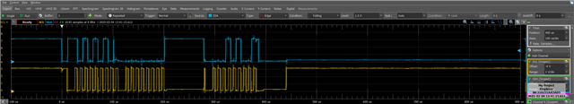

nRF52840 on PC10056 dev board operating as an I2C controller with a target that uses clock stretching while operating at "standard speed" (100kHz).
nRF Connect SDK v2.7.0-5cb85570ca43
Dev kit has DETECT (shield detect) pulled low to enable the onboard pull ups.
I note that there are quite a few semi-related previous posts, however the threads contain a lot of conjecture and hand waving. None that I have found really get to the bottom of the issue or have a viable solution.
This issue has come up on pre-production hardware as an intermittent bug, I have replicated it on the dev kit to avoid distraction about hardware. However this is problem in a mature project with considerable NRE behind it.
Issue observed
When reading from the target (and possibly in other transactions) with i2c_write_read_dt() the TWIM occasionally produces a significantly shortened clock pulse after the target stretches the clock. I have observed this in particular on first clock after a stretch, after the controller has sent an ack in response to a byte from the target. I suspect I have seen it elsewhere, however, that was before I appreciated what I was looking at.
The shortened clock is of varying length down to 1.2us, when optimistically measured at the first observable change in the trace. In practice, after considering thresholds for high and low, it ends up in the region of 850ns from the point of view of the target in a practical design.
In this case, the target disregards clock periods under 4us. A feature that mitigates the effect of noise on SCL. Not an unreasonable margin of 20% from the expected 5us clock period.
If there is any doubt about this being a feature, I have seen the lack of this feature in other targets cause no end of headache during compliance testing. An example result being a locked up bus during ESD testing.
It is also of note that even if the bus had no capacitance and the pull ups were magic resulting in no rise time, the clock pulse is still only 1.2us.

  • So I am having this issue where after a NACK (its clock pulse seems awfully short) and the SDA line does not lift. I want to make sure this is the same issue before proceeding to test these workarounds.
  • Looks to me like there are 3 clock stretches here, 1st 90uSec ok, 2nd 60uSec ok, 3rd 80uSec has short clock pulse. Using just the timer to hold off transmission for 100uSec would mean the short clock pulse would not occur, it would stay high for the duration of SUSPEND, so SUSPEND on every clock edge (some of these SUSPENDs are of course redundant but I think benign) and also clear and start the Timer on each clock pulse, then the timer issues the RESUME and timer stop after 100uSec (or maybe 200 uSec).
    What can go wrong? Well the assumption is that SUSPEND really does suspend so the SCL doesn't get pushed low after that short rising edge, and that's a question for Nordic hardware guys.
    16MHz clock with SCL at 100kHz is 160 16M clocks per clock; I suspect there is a race hazard internally that shows up if the external asynchronous event - the end of the hold-SCL-low clock stretch - is not an integer multiple (or close to) of 160 16M clocks. Funnily enough the one that fails is the one that is an integer multiple.
    Will this work? Best I can think of without hardware design changes ..
    Edit: Maybe you could look at the numbers more accurately than I can for the discussion on the race hazard, no help for us but would allow Nordic to fix the issue in the next die revision :-)
    Edit2: Worst case if this doesn't work try having a spare open-drain output pin H0D1 to be driven low every 8 clock edges to force a clean known-width (using 100uSec timer) stretch after every byte.
  • So I took some more measurements and found that there extra pulse is present:
    Will try out the workarounds and see if it improves the reliability of the communication.
  • Uh-oh, that last trace shows more clearly that the TI slave is clock-stretching before the ACK/NAK clock pulse, presumably so that it can decide whether to Ack or Nak the data byte. SUSPEND activates after the ACK/NAK clock cycle, so that solution won't work - pity.

    • Set a spare port pin to be H0D1 output
    • Start a Timer at the same time as the TWIM events STARTED using PPI
    • Set the Timer CC[0] register to trigger the spare port pin Low via PPI after a time equal to 9 x SCL clock cycles, say 90 uSecs, after the 9th clock and coincident with a slave clock stretch if one is in progress but before the next byte clock if no slave stretch is in progress
    • Set the Timer CC[1] to clear the timer and set the port pin High (actually float as open-drain) via PPI to end the synchronous stretch say after another 100uSec, ie at 190uSec
    • Stop and Clear the Timer and set the port pin High (actually float as open-drain) on the TWIM events STOPPED using PPI
    • Tune this synchronous stretch to be longer than the longest slave stretch but without generating the race-hazard pulse
    Seems to work; the new output pin should be connected to the SCL to extend the stretch initiated by the TI slave by a (safe) synchronous amount, or if no added stretch from the slave it will add a spurious (but safe) stretch. The clocks for both TWIM and Timer are synchronous from 16MHz regardless of whether using the crystal. The synchronous stretch is added for every byte regardless of whether requested by the slave.
    Edit: Added missing FORK, fixed a typo, playing with timing
