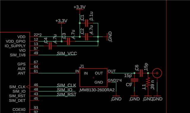

I'm working with a custom board build with an nrf9161, I've created my board from nrf9161dk board (change some pin and defintion), I'm able to flash and build? I can use my custom led, my i2c bus, so I thought my custom board is well defined.
Right now I'm trying to use onomondo softsim profile, but ùy softsim never connect. To debug I've tried to do this here but same result not working. Just to know I have tried my source code with nordic nrf9160dk and it's working I'm able to have lte event and I can see my sim connected on onomondo, so the bug is not on my code...

I can upload my board definition, tell me. Don't understand why it's working on 9160dk and not on my board, maybe bad board definition, I hope it's not an hardware issue with my custom board
Thanks for help

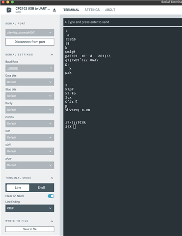

  • Hi Simon,
    regarding the capturing of the trace. You have to cpature it to a file and open it.
    The antenna connection, are you able to see TX operation from your board with a spectrum analyser? Again, I don't know what the HW looks like, but the antenna connection is definitely something to follow. I suspect the receiver on the nRF91 on your custom board is able to receive singals from the network, but the outgoing connection request and TX operations are not getting through back to the network. Placement of the antenna and location of the kit compared to windows and obstacles is worth testing out.
    Best regards
    Asbjørn
  • Hi Asbjørn
    When I'm trying to capture with nrfutil my trace is always zero octet.
    ./nrfutil device list
    101c4425765aed11b7fd8a1d4f779c9c
    product         CP2102N USB to UART Bridge Controller
    ports           /dev/tty.usbserial-14320
    traits          serialPorts, usb
    1
    product         CP2102 USB to UART Bridge Controller
    ports           /dev/tty.usbserial-0001
    Found 2 supported device(s)
    usbserial-0001 is cp21 where uart1 is connected (if I use nrf serial terminal with 1000000 baudrate I see datas)
    ./nrfutil trace lte --input-serialport /dev/tty.usbserial-0002 --output-raw trace.raw
    trace.raw is always empty... Don't understand why because I see my cp21 rx led blinking
    For my nrf here is the part of my schematic for LTE
    usbserial-001 is where the uart1 is connected, but you usbserial-0002 as input for capturing the trace? Is this a typo is there something I'm not seeing there? What happens if you use usbserial0001 for the trace capture command?
    The radio part of the design schematic looks as the connector we have used on the nRF91xx-DK. Do you have some sort of spectrum analyzer available to verify the output from the cable once connected to the J1 connector? The flex antenna you are using, does that work with the DK you have available with the nRF9160?

  • usbserial-001 is where the uart1 is connected, but you usbserial-0002 as input for capturing the trace? Is this a typo is there something I'm not seeing there? What happens if you use usbserial0001 for the trace capture command?
    Sorry it's a typo error, I'm using usbserial-0001 for capturing data without success, trace;raw is always empty.
    Here is what I got if I'm using serial terminal on usbserial-0001
    QwBx
    Unfortunately no I don't have it
    I can test it

    Sorry for the delay, I was on another project. Right now I can get trace from UART1 and my modem. I've attached to you the mtrace file give by cellular monitor. The file contains all trace beetwen boot and

    Are you able to see something? I don’t understand why I have no packet when I’m loading mtrace file to nrt monitor, However, I have a data in my file… As I'm using mfw_nrf91x1_2.0.2 I've selected 2.0.2 in modem trace database in cellular monitor
    It's look like cellular monitor can't send AT command to my custom board
