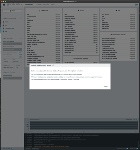

    EDIT: I think I've succefully activate trace modem with uart1, if I'm connected to uart1 with usb ttl and connect on it with nrf serial termina, set baudrate to 1000000 I can see some char like

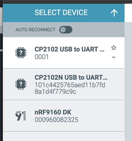

    But if I'm tying to connect to the same uart1 with Cellular monitor I always got "Tried to send AT command to device, but no serial port is open". I don't understand why, because if I send AT command from serial monitor to uart0 it's working, how cellular monitor know where he should send AT command ?
    Here is my list device :
    First CP2102 -> uart1 trace modem (use with celullar monitor)
    Second CP2102 -> uart0 where I print with LOG_INF for example or printk (used with serial monitor)
