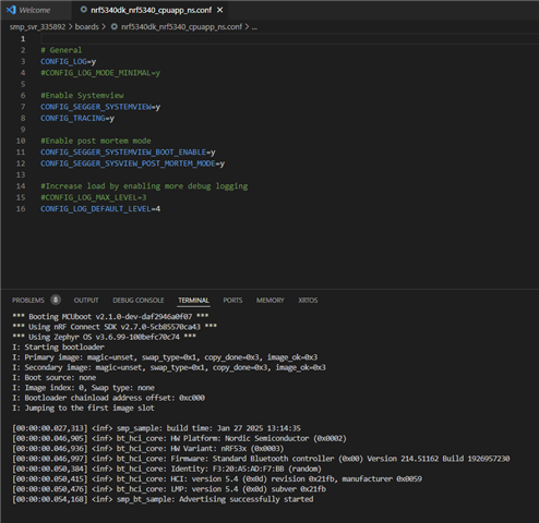

Step 3 - Increase load by enabling more debug logging
#CONFIG_LOG_MAX_LEVEL=3
CONFIG_LOG_DEFAULT_LEVEL=4

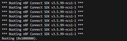

2.6.1 bootloops without any interesting log messages:
I: Starting bootloader
I: Primary image: magic=bad, swap_type=0x0, copy_done=0x2, image_ok=0x2
I: Secondary image: magic=unset, swap_type=0x1, copy_done=0x3, image_ok=0x3
I: Boot source: none
I: Image index: 0, Swap type: none
I: Bootloader chainload address offset: 0xc000
*** Booting nRF Connect SDK 3758bcbfa5cd ***
2.7.0 crashes with a hard fault:
Any ideas?

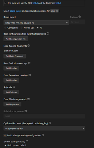

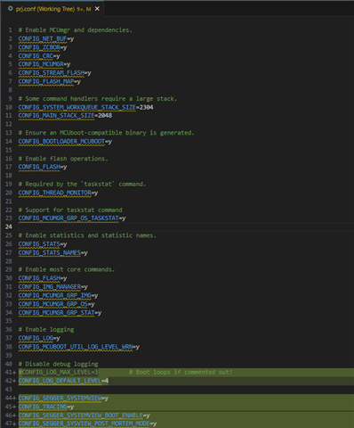

    I believe I am able to replicate the issue from Rait's initial post, with the following:
    1. Open ncs\v2.6.1\zephyr\samples\subsys\mgmt\mcumgr\smp_svr
    2. modify prj.conf as shown:
    3. Create build configuration as shown:
    4. Flash to nrf5340dk
    5. Serial log shows boot looping behavior:

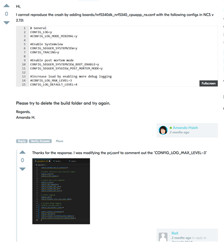

    Looks like you are commenting out CONFIG_LOG_MAX_LEVEL=3 in different .conf rather than the prj.conf?
    Samuel S.
