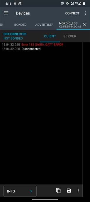

I'm working on understanding how whitelist filtering is implemented and works in Bluetooth Low Energy. I'm currently following Exercise 2 in Lesson 5 of DevAcademy's Bluetooth Low Energy Fundamentals, but I can't get it to work - even using the solution provided by Nordic.
I've compiled and flashed the blefund_less5_exer2_solution to the nRF52-DK and I'm using the nRF Connect app on my phone for the scanning and GATT Client part. However, I can't connect. I have tried clearing the accept list and advertising in pairing mode, but the app returns a generic error: 133(0x85): GATT ERROR.
Here is also the output from the serial terminal:
Could someone test this to see if it’s just me experiencing this issue? Or, does anyone have suggestions for what I might be doing wrong?

    Thanks for the update. This issue is a bit frustrating - I'm not sure if the problem is with the nRF Connect app or if something is wrong with the BLE peripheral. ( I tried to erase the whole flash with "erase all and flash" and it did not help.)
    On the first run, everything works as expected: connecting, whitelisting and bonding all work fine. However, when I try to delete everything (bonding and whitelisting) on both the phone and the peripheral, I can no longer connect. To make it work again, I have to 'force stop' the app on Android and then re-open it; only then can I connect, whitelist and bond again.
    I’ve repeated this process a few times and encountered the same outcome each time.
    Could anyone else try to reproduce this issue? I’m hopeful this can be resolved in a future update.
    What app is that? The nRF Connect for Android?
    Can you please upload the peripheral application that you are testing on? This will make it a lot faster for me to reproduce.
