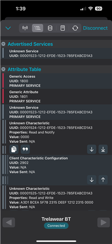

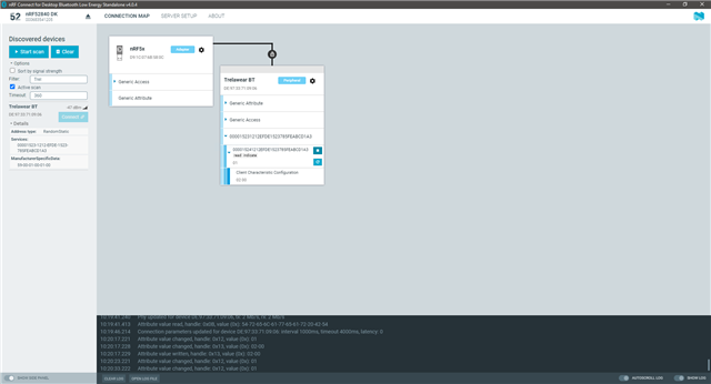

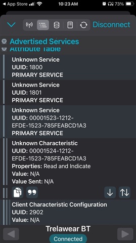

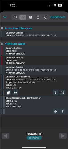

I verified the device tree with LEDs, button handling, and logging everything seems to work as expected.  I then setup my Bluetooth service and on the dev kit everything works exactly as expected.  Using the nRF Connect for mobile Sniffer this is what I see and expect when I connect to the device:
However, when I flash my second configuration (the custom board) everything works exactly as expected except the service when connected to the Sniffer.
It seems to be still using the service from the old project I am working to replace.  I have fully erased the board multiple times using both the nRF Extension and J-Flash tool.  I am completely at a loss as to where the device is getting this service from considering the rest of the code is operating exactly as the dev kit.
