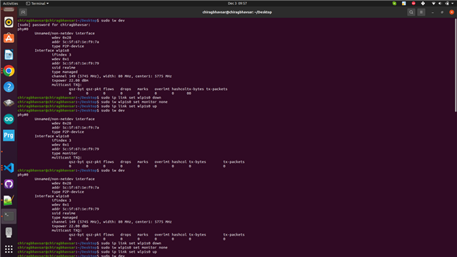

    I have tested further your previous project HTTP.zip. There seems to be connection consistently. The change was to extend the sleep to allow for initialization of the wi-fi driver using k_sleep(K_SECONDS(10)); instead of k_sleep(K_SECONDS(1));
    [00:00:00.502,746] <inf> fs_nvs: 2 Sectors of 4096 bytes
    [00:00:00.502,746] <inf> fs_nvs: alloc wra: 0, fd0
    [00:00:00.502,777] <inf> fs_nvs: data wra: 0, c8
    *** Booting nRF Connect SDK v3.5.99-ncs1-1 ***
    [00:00:02.055,969] <inf> wifi_mgmt_ext: Connection requested
    [00:00:02.056,732] <inf> Lesson5_Exercise1: Connecting to Wi-Fi
    [00:00:04.606,048] <inf> wifi_mgmt_ext: Connection requested
    [00:00:07.159,393] <inf> wifi_mgmt_ext: Connection requested
    [00:00:09.713,409] <inf> wifi_mgmt_ext: Connection requested
    [00:00:12.267,883] <inf> wifi_mgmt_ext: Connection requested
    [00:00:14.834,533] <inf> wifi_mgmt_ext: Connection requested
    [00:00:17.400,695] <inf> wifi_mgmt_ext: Connection requested
    [00:00:19.947,631] <inf> wifi_mgmt_ext: Connection requested
    [00:00:22.501,220] <inf> wifi_mgmt_ext: Connection requested
    [00:00:25.055,206] <inf> wifi_mgmt_ext: Connection requested
    [00:00:27.609,893] <inf> wifi_mgmt_ext: Connection requested
    [00:00:30.181,518] <inf> wifi_mgmt_ext: Connection requested
    [00:00:30.264,404] <inf> Lesson5_Exercise1: Network connected
    [00:00:32.203,094] <inf> Lesson5_Exercise1: IPv4 address of HTTP server found 54.240.174.114
    [00:00:33.456,909] <inf> Lesson5_Exercise1: Connected to server
    [00:00:33.456,939] <inf> Lesson5_Exercise1: HTTP POST request
