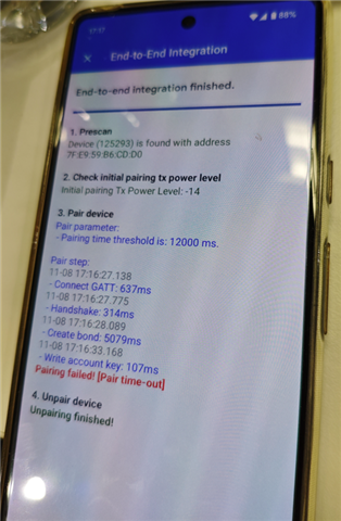

First, I tried your version of model ID 0x4A436B, I used a google pixel 7 phone to scan for the fast pair packets and there is no pop-up. I then switched to my own model ID and tried the google validator app.The rsult is shown in the following image
I have captured the in-air BLE packages and have found out that the phone terminated the connection right after an account key write. My NRF5340 UART showed a disconnect event with reason 19.
May I ask what caused this issue please? I haven't changed anything in the code so I expect this example to work out of the box. But the phone keeps terminating the connection. Ironically, the same model ID works perfectly fine on input device example, with no disconnecting and a pairing success on validator app. The set up of the model ID matches that of the model ID provided by Nordic.

    The End-to-end integration Fast Pair Validator test is not applicable for the Fast Pair locator tag sample.
    Could you elaborate more on the reason why the locator tag example is not able to pass the validator test? I don't see much differences in the pairing process except for the last immediate disconnection after write to account key.
    Besides from using the phone app, is there another tool that I can validate my own implementation of the locator tag service?

  • You can only validate if the DK is advertising the Fast Pair Model ID correctly in the discoverable mode (the same advertising as in the input device sample but different Model ID code). If it is, you should ask the Google team for support regarding the missing pop-up.
    The other thing that you should check is whether your test phone is set up with multiple accounts. We have experienced some issues on phones that are set up with multiple accounts. I recommend always having just one account on your test device. This account should also be on the Google accept list.
