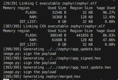

I’m working on a firmware project for the NRF52840 that utilizes BLE, DFU, I2C, WDT, some cryptographic libraries, and a few sensor libraries. However, despite having 1MB of flash memory, I’m hitting the limits of this configuration, because my flash is separated for DFU.
Flash organization (very simplified, in fact I have less memory in slot1 and 2)
flash organization
Coming from a bare-metal development background, where 1MB is considered a substantial amount of memory, this feels quite unusual to me.

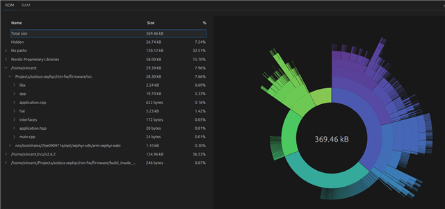

My own code occupies less than 8% of the total build, meaning over 92% of the memory footprint comes from Zephyr/NCS.
In my honest opinion, that’s pretty astonishing.
Look, NCS  2.6.2 is taking 135Kb of flash, whouah !
Is there a way to reduce this ?
flash footprint
