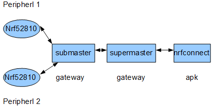

We are currently starting a project using the nRF52832 as our controller, Segger Embedded Studio 5.42a as our IDE, and nRF5 SDK version 17.0.2.
Project Requirement Explanation:

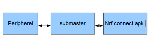

I want to create an nRF52832-based gateway module that can connect peripheral devices and the nRF Connect app simultaneously.
  1. Initial Connection: Nordic UART Service-based BLE peripheral devices automatically connect to the gateway device. In this stage, the gateway device acts as a central device.
  2. Gateway as Peripheral: After peripheral device connection, the gateway device acts as a peripheral, advertises, and connects to the nRF Connect app.
  3. Data Sharing: Once connected to the app, the gateway device shares the connected devices' MAC IDs, device names, and Nordic UART data received from peripheral devices.
  4. Command and Data Transmission: When the app sends data or commands along with a specific peripheral device's MAC ID, the data is sent to the corresponding device.
Steps Followed:
To meet these requirements, I examined the nRF5 SDK for a suitable concurrent central and peripheral example project. The ble_app_uart_hrs_rscs project seemed like a good starting point. I incorporated parts of the ble_app_uart_c project for central NUS data handling and the ble_app_uart project for peripheral data handling. I also modified the RAM start address to 0x20004718 in the section placement macros.

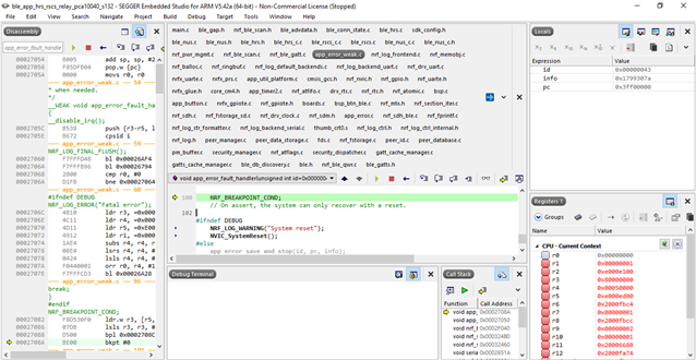

However, I'm encountering a fatal error after enabling the SoftDevice. I'm unsure about the cause and whether my NUS integration into the ble_app_uart_hrs_rscs project is correct. I'll attach the code for further clarification.

    When I am debugging the code, it stops inside the idle_state_handle() function. I have attached the code above this ticket. What could be the reason for the fatal error and system reset? Is my NUS integration incorrect? Could you please help us to find the issue? Your response is invaluable.
    Can you check which exact function call returned an error and what the error code was? In most cases, enabling debug logging as explained in my previous post should bee nough. Alternatively, you can set a breakpoint in the error handler and inspect the info struct yourself as explained in this post (it is old but stil mostly valid).
  • when iam debugging the code the iami getting this
    Yes, that is expected. It is in the error handler. To find out which error occured where, you should either enable debug logging as shown in a previous post, or inspect the info struct as shown in the link in my last post. That way you will find out in which file and which line number the error was detected, which will allow ut to proceed.
  • hi , We couldn't trace the error exactly, so we decided to start from scratch. Initially, we added the NUS_C parts from the ble_app_uart_c project to the ble_app_hrs_rscs example project. However, an error code 4 is being returned from the NUS_C initialization. This error code 4 relates to a memory issue. I checked the section placement macros and made the necessary changes, but the issue is still not resolved. We are still getting the error code, and the system resets. Your response is very valuable. We have been stuck on this issue for the past few days while integrating NUS into the ble_app_hrs_rscs example project.
  • i will attach the code for better understanding

    static void ble_nus_c_evt_handler(ble_nus_c_t * p_ble_nus_c, ble_nus_c_evt_t const * p_ble_nus_evt)
        ret_code_t err_code;
        switch (p_ble_nus_evt->evt_type)
            case BLE_NUS_C_EVT_DISCOVERY_COMPLETE:
                NRF_LOG_INFO("Discovery complete.");
                err_code = ble_nus_c_handles_assign(p_ble_nus_c, p_ble_nus_evt->conn_handle, &p_ble_nus_evt->handles);
                err_code = ble_nus_c_tx_notif_enable(p_ble_nus_c);
                NRF_LOG_INFO("Connected to device with Nordic UART Service.");
            //case BLE_NUS_C_EVT_NUS_TX_EVT:
            //    ble_nus_chars_received_uart_print(p_ble_nus_evt->p_data, p_ble_nus_evt->data_len);
            //    break;
            //case BLE_NUS_C_EVT_DISCONNECTED:
            //    NRF_LOG_INFO("Disconnected.");
            //    scan_start();
            //    break;
    static void nus_error_handler(uint32_t nrf_error)
        APP_ERROR_HANDLER(nrf_error);
    static void nus_c_init(void)
        ble_nus_c_init_t init;
        init.evt_handler   = ble_nus_c_evt_handler;
        init.error_handler = nus_error_handler;
        init.p_gatt_queue  = &m_ble_gatt_queue;
        err_code = ble_nus_c_init(&m_ble_nus_c, &init);
        NRF_LOG_INFO("ble_nus_c_init : %d\n",err_code);
