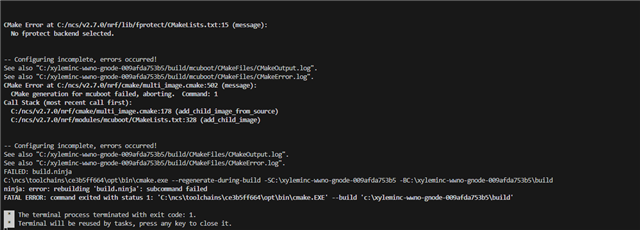

I am working on a custom Agora board that includes a BT40 module with an nRF5340 MCU. I am trying to enable the MCUboot bootloader by setting CONFIG_BOOTLOADER_MCUBOOT=y in my prj.conf file. However, I encounter an error during the initial configuration stage.

Error Message:
...depends again on SOC_FAMILY_NRF (defined at C:/ncs/v2.7.0/modules/soc-hwmv1/soc/arm\nordic_nrf\Kconfig:9)
CMake Error at C:/ncs/v2.7.0/zephyr/cmake/modules/kconfig.cmake:392 (message):
C:/ncs/v2.7.0/nrf/cmake/modules/kconfig.cmake:29 (include)
C:/ncs/v2.7.0/zephyr/cmake/modules/zephyr_default.cmake:132 (include)
C:/ncs/v2.7.0/zephyr/share/zephyr-package/cmake/ZephyrConfig.cmake:66 (include)
C:/ncs/v2.7.0/zephyr/share/zephyr-package/cmake/ZephyrConfig.cmake:97 (include_boilerplate)
CMakeLists.txt:12 (find_package)
See also "C:/Users/YASHAWS/Agora/xyleminc-wwno-gnode-009afda753b5/build_4/mcuboot/CMakeFiles/CMakeOutput.log".
See also "C:/Users/YASHAWS/Agora/xyleminc-wwno-gnode-009afda753b5/build_4/mcuboot/CMakeFiles/CMakeError.log".
CMake Error at C:/ncs/v2.7.0/nrf/cmake/multi_image.cmake:502 (message):
CMake generation for mcuboot failed, aborting. Command: 1
C:/ncs/v2.7.0/nrf/cmake/multi_image.cmake:178 (add_child_image_from_source)
C:/ncs/v2.7.0/nrf/modules/mcuboot/CMakeLists.txt:328 (add_child_image)
See also "C:/Users/YASHAWS/Agora/xyleminc-wwno-gnode-009afda753b5/build_4/CMakeFiles/CMakeOutput.log".
See also "C:/Users/YASHAWS/Agora/xyleminc-wwno-gnode-009afda753b5/build_4/CMakeFiles/CMakeError.log".
FAILED: build.ninja
C:\ncs\toolchains\ce3b5ff664\opt\bin\cmake.exe --regenerate-during-build -SC:\Users\YASHAWS\Agora\xyleminc-wwno-gnode-009afda753b5 -BC:\Users\YASHAWS\Agora\xyleminc-wwno-gnode-009afda753b5\build_4
ninja: error: rebuilding 'build.ninja': subcommand failed
FATAL ERROR: command exited with status 1: 'C:\ncs\toolchains\ce3b5ff664\opt\bin\cmake.EXE' --build 'c:\Users\YASHAWS\Agora\xyleminc-wwno-gnode-009afda753b5\build_4'
* The terminal process terminated with exit code: 1.
* Terminal will be reused by tasks, press any key to close it.
Could anyone provide guidance on how to resolve this issue or suggest additional configurations that might be required for the nRF5340 MCU on a custom board?
Thank you!
    I amo not able to see exactly what the error is, but it the path is long which can cause problems on windows. I sit possible to rename and move things so that you make "C:/Users/YASHAWS/Agora/xyleminc-wwno-gnode-009afda753b5" much shorter? Do you still see the same error after that?
    Thank for the suggestion. I'll try to shorten the path.
    But the Error is -FAILED: build.ninja
    This is the main issue is facing and after enabling the CONFIG_BOOTLOADER_MCUBOOT=y on prj.conf file.

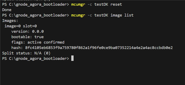

    These are thing which we tried but the successfully new bin file is loading but once i press the reset after that, changes are not reflecting in the hardw
    After the firmware is transvered it needs to be activated. This can be done permanently or a single time ("test"). This must be configured before the reset, and then the bootloader will swap in the new image upon boot. If there are issues here, perhaps you can share exactly what you are doing (specifying board and step by step instrutions), and in what way it does not work?

    2. After the firmware is transvered it needs to be activated. This can be done permanently or a single time ("test"). This must be configured before the reset, and then the bootloader will swap in the new image upon boot. If there are issues here, perhaps you can share exactly what you are doing (specifying board and step by step instrutions), and in what way it does not work?
    After the updating I'm giving the confirm to done permanently swap with primary address.This one also I'm doing before the reset it itself by giving mcumgr -c testDK image confirm <NEW_HASH>.

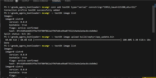

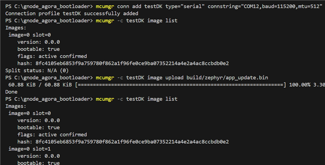

    2. I am using mcumgr command line tool to perform DFU. I have used same commands mentioned in Exercise 1 - DFU over UART - Nordic Developer Academy By using this i am able do the DFU for nRF5340dk board and new firmware upgrade sucessfully.
    I will share the commands which used to update new firmware using mcumgr commands.
    At this time new firmware binary file upload but after the reset that new is not reflecting the hardware.
    You can see the pending permanent after trying swap to primary address.
    after that I will do reset then also the same.
    The same bootloader that works successfully on DK board, when I tried same thing with the custom board, new firmware is not updating in the hardware, but commands are working.
    Thank you
    OK, everything looks good here, with nothing here explaining why the new image is not activated. Do you have logging enabled in MCUboot? If not, can you enable it and share the log here? That should show us what happens after the reste when the new image should have been swapped in and booted.
