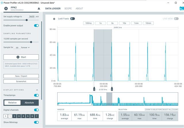

    I still have questions, as shown in the picture, TWT mode and DTIM mode. How is the peak in the image caused in TWT mode?
  • I want to compare the power consumption of TWT and legacy power save mode under the same conditions, as the legacy power save mode is 100 ms.
    As you said, the legacy power save mode is 1.78mA, and TWT is 40.95mA, as shown in picture 1 and picture 2.
    But when I send a package the legacy power save mode consumes more power than TWT.

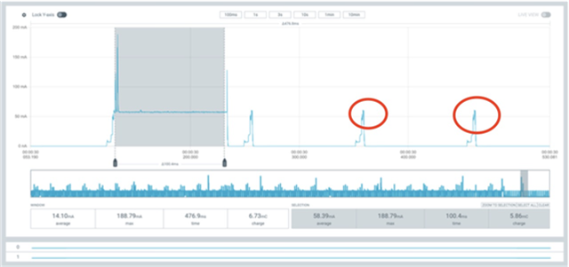

    as shown in picture 3 and picture 4.  TWT average is 44.35mA, and the legacy power save mode is 58.31mA  in 100ms.
    So, why does the legacy power save mode consume more power than the TWT mode when sending a package?
    Because the radio is on for a longer period of time with legacy power save mode. As is explained in the Power save modes topic in DevAcademy, with legacy power save mode, the device sends a PS poll to the AP to inform the AP that it is ready to receive data. The STA will be awake until it receives a frame from the AP with the More Data subfield set to 0, indicating that the AP does not have any more buffered data to send to the STA. In your case, this interaction seems to take 100 ms.
    When it comes to TWT, you have configured the TWT interval to be 100 ms and the wake interval to be 65 ms. This means that for each TWT period, which is 100 ms, the device will be awake for 65 ms and asleep for 35 ms. It does not wait to receive a frame from the AP with the More Data subfield set to 0 before going to sleep, it goes to sleep after being awake for 65 ms, as is agreed upon with the AP. If more data is buffered on the AP, this will be sent during the next wake-up instead.
    The nominal current consumption for RX is 60 mA for 2.4GHz and 56 mA for 5GHz, so the extra 35 ms that the device is awake for with legacy power save will greatly impact the average current consumption.
    The best improvement of TWT is that the device can be asleep for a longer period of time than with legacy power save mode, so comparing the current consumption under the same conditions does not really show the advantages of using TWT. However, for a fairer comparison, I would recommend reducing the TWT wake interval when having such a short TWT interval, as 65 ms wake interval is rather long when the total TWT interval is 100 ms. You can change this by changing the TWT_WAKE_INTERVAL_MS or directly changing params.setup.twt_wake_interval in wifi_set_twt() instead.

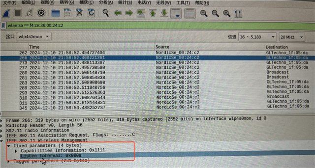

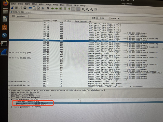

  • OK, thank you . So, after it goes back to sleep, How is the peak current in the picture caused?
    I captured the package by the Wireshark and found that there is no package about STA, just about some AP broadcast package.
    As described in the official document "This means that the STA must send a PS-Poll frame for every downlink frame, which is sub-optimal with regards to efficiency and reducing overhead control signaling."https://academy.nordicsemi.com/courses/wi-fi-fundamentals/lessons/lesson-6-wifi-fundamentals/topic/power-save-modes-2/
    So, I think the peak current is caused by the "ps-poll" package, but sta nrf7002dk does not send any package. that is my question.

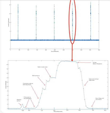

    And I want to know the the peak current include the package detail, just like the follow picture shows. can you give me some help?
