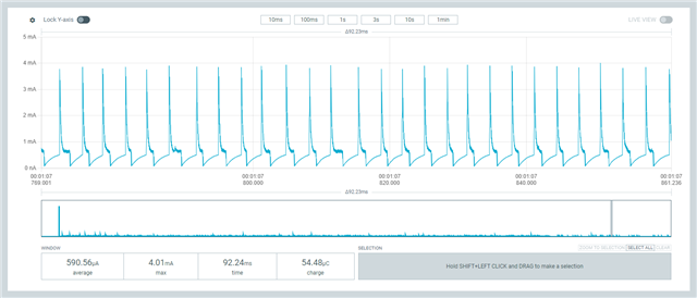

    The current looks like this:
    This looks like some peripheral waking up every ~4ms. Maybe a timer?

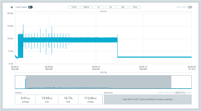

    I was not able to reproduce the same current on the DK.
    I modified the coap_client example to autojoin, and added otRadioPlatSleep() after running for 10 seconds.
    After 10 seconds, the current is 2.6 mA.

  • My custom board:
    • once it joins a network successfully and is commissioned, draws ~13 uA on average
    • If it does not join a network, then calls otPlatRadioSleep() draws ~590 uA (see PPK2 plot above)
    nRF52840DK
    • If it does not join a network, then calls otPlatRadioSleep() draws 2.6 mA (see PPK2 plot above)

    At this point, I am not sure what those spikes on your custom board are coming from, and I don't know how to, or if it is possible to reproduce them on a DK, or if it is some component on your custom board drawing these current spikes.
