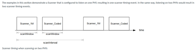

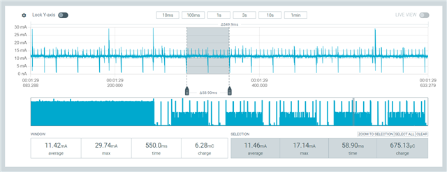

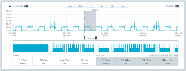

The scan window does not alternate properly with the BT_LE_SCAN_OPT_CODED option in the scan parameters. Specifically, the scan window does not toggle on and off every 30 ms as expected with a 30 ms scan window and a 60 ms scan interval. However, when using the BT_LE_SCAN_OPT_NONE option, the scan window operates correctly, toggling on and off every 30 ms as configured.
