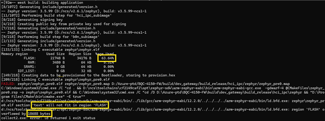

    Here's a screen capture of the build output that shows the error.  This error seems strange to me because the "Memory usage" indicates that the FLASH memory region is only 63% full, but then a few lines later there is an error message stating that the FLASH memory region has overflowed by 18688 bytes.
    I am not sure where the FLASH memory region is defined.  In the "build/dev_gateway/build_release" directory I found a file named "regions.yml", but this file has no region named "FLASH".  Do you know which part of the system defines this "FLASH" memory region?
    I added a status message to the top-level CMakeLists.txt file to verify that the CONFIG_AUDIO_DFU value is set to "2", which then causes the build system to include the mcuboot config and the pm_dfu_external_flash.yml partition files.

    The strange thing about this error message is that the FLASH overflows by the same amount if I set CONFIG_AUDIO_DFU to "1", which I would think would overflow the internal flash by a much larger amount than if the secondary images are being re-directed to the external flash.
    Any ideas of what to check next?

    Were you able to perform DFU from external flash with a minimal sample, for instance the one in the lessons I sent on your custom hardware? I strongly recommend doing this with a minimal sample before porting to a full scale application. Or try to apply the lesson 3 steps to the peripheral UART sample found in the SDK.
    Lets assume you've succeeded in that and go on in the meanwhile:
    Within the build folder I would expect that you find a "partitions.yml" within the first level of the build folder, i.e build/partitions.yml This is the generated partitioning map for that build. It should look something like this (The Matter Weather station project which showcases DFU over external flash):
    To clarify, I've only seen the CONFIG_MCUBOOT_SERIAL=y present (which is what they use in lesson 2 I sent, but not in lesson 3). Is your end goal to set up only serial DFU, BLE FOTA or both of them?
    Is CONFIG_PM_SINGLE_IMAGE=y from a sample, course or something you've set up your self? I recommend that you do simultaneous DFU instead of one and one image so that you don't risk breaking the HCI interface between the app-core and the net-core due to versioning incompatibility.
    In NCS 2.6.x (or anything below 2.7.0), Flash memory region is set either dynamically or statically. If you don't have a pm_static.yml within your project folder, then the build system will build everything dynamically and try to place things roughly where it should be. For complex applications using multiple subsystems, for instance BLE which requires a settings partition, the SD card config which requires a NVS partition, external flash DFU which requires a secondary app partition and MCUboot (and b0 if you have updatable bootloader), we recommend you statically set up your own partition using the pm_static.yml so that you have full control over the placements both now and in the future if you need to do an update.
    I agree. My guess is that it has not been set up to use external flash, but I can't be sure since I don't know what CONFIG_AUDIO_DFU=2 does. Is this something you could share? If so, I'll have a look
    Andreas
  • Hi Andreas,
    Apologies for my slow response.  I have been able to get the system to fit into the on-chip flash with mcuboot by disabling some of the Bluetooth controller features listed in the child_image/hci_image/*.conf files.
    Now that the code compiles and links, it does not boot correctly, but that is a different issue than the question posed in this support ticket.  I think we should consider this issue closed and I will submit a new issue about debugging the mcuboot process.
    Thanks for your help,
    -- Kristopher
