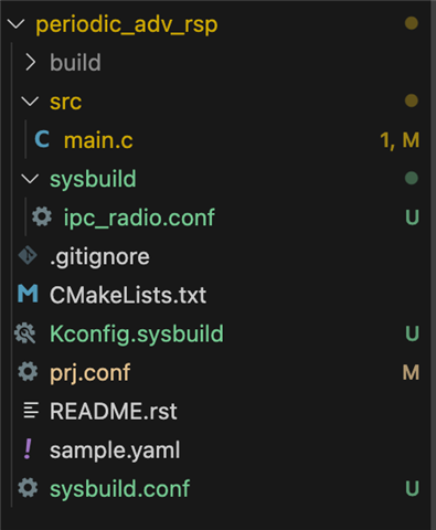

    If you are using parent child image functionality (not recommended for future development), add a folder called child_image, and inside there, add a file called hci_ipc.conf. The file should contain:
    CONFIG_BT_BUF_ACL_RX_SIZE=251
    CONFIG_BT_BUF_ACL_TX_SIZE=251
    CONFIG_BT_EXT_ADV=y
    CONFIG_BT_PER_ADV=y
    CONFIG_BT_PER_ADV_SYNC_TRANSFER_SENDER=y
    CONFIG_BT_PER_ADV_RSP=y
    And this is your folder structure:
    If you are using the new sysbuild, then you should add call this file ipc_radio.conf, and place it in a folder called "sysbuild" instead of "child_image". In addition, you need a couple of files to tell the sysbuild building system that you have an additional image. I copied them from the ncs\nrf\samples\bluetooth\peripheral_uart sample:
    additional files.zip
    (Kconfig.sysbuild and sysbuild.conf)
    To build using sysbuild, there is a checkbox in the bottom of VS code when you configure your build configuration. If you are using command line to build, add the argument "--sysbuild".
