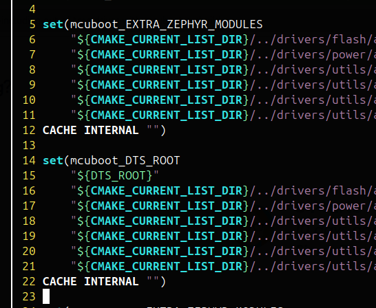

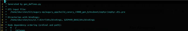

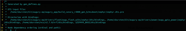

  • i was able to find a simpler solution by adding sylinks to my boards dts/bindings folder. sysbuild looks in the application folder and the board folder for DTS files by default
  • Hi. Thanks for sharing this problem and solution. I too needed sysbuild to include out of tree drivers for MCUBOOT.
    I followed your approach and set the mcuboot_EXTRA_ZEPHYR_MODULES to point to my drivers folder in my sysbuild.cmake and it works! So thanks for sharing.

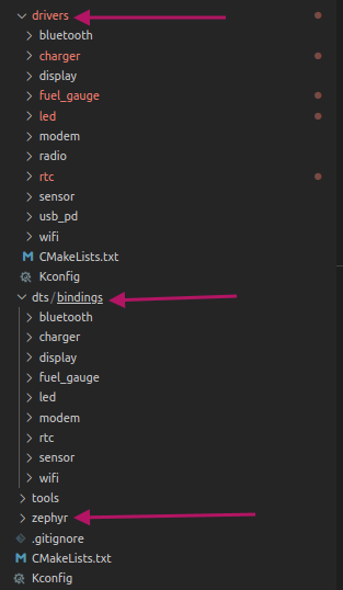

    However I don't know if this can help your situation: I don't need to set the dts_root because I structure my out of tree "drivers" folder to follow zephyr's module structure (which includes a Zephyr folder containing module.yaml). That points the dts_root to the same folder, along with the start of my KConfig chain. My out of tree dts reside along side my drivers. Additionally, whole folder is a git  submodule which I can pull in other projects. You then don't need to worry about creating symlinks for each project.
    Hope that helps!
