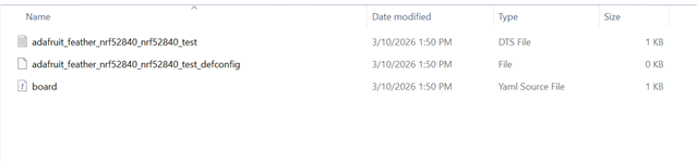

When following the guidline of a new way to extend boards, VSCode "Add Build Configuration" is blank. Am I doing something wrong or this is not yet supported by nRF VSCode extension?
Attached is a sample project with the following "board.yaml":
board:
  extend: nrf52840dk
  variants:
    - name: test
      qualifier: nrf52840
extended_board_test.zip

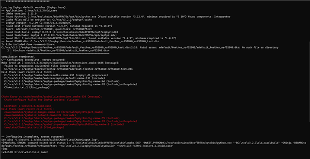

    I have looked at your application folder and also run the sample on NCS V3.2.0. Your board file is incomplete.
    It does not look like a proper board file.
    The error shows
    You mentioned earlier that ''It's not the build that fails. It's the VSCode nRF Extension that cannot start debug session. And it cannot show graphical representation of DeviceTree either.'' Can you send me the application folder which you were able to build?
  • Well, yeah, That is the problem still not solved, that was discussed earlier in this thread. A quick and simple work-around is to add the line:
    list(APPEND DTS_EXTRA_CPPFLAGS "-isystem$ENV{ZEPHYR_BASE}/boards/")
    ...to the original board "pre_dt_board.cmake" file, in Zephyr source tree.
