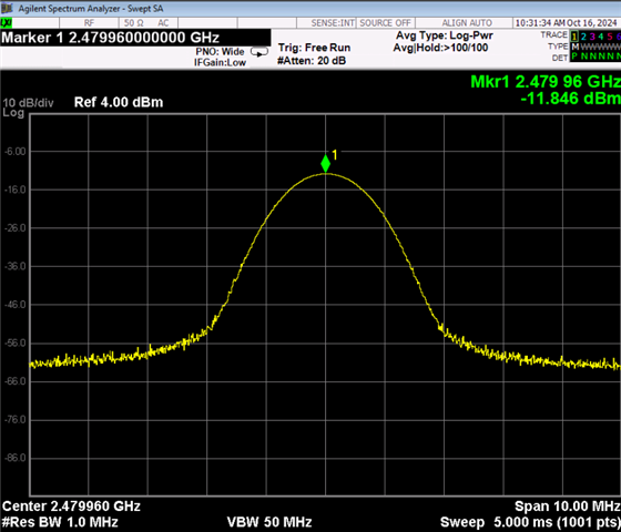

The issue is that the radiated power at 2480 MHz during the Radio Test is 10 dB lower compared to other channels.
We developed firmware based on the sample provided at the following link to pass Japan's technical standards compliance test
https://docs.nordicsemi.com/bundle/sdk_nrf5_v17.0.2/page/nrf_radio_test_example.html.

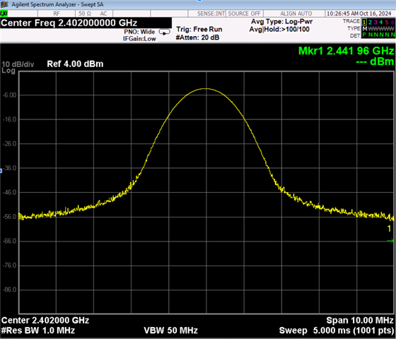

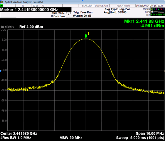

However, during testing, we received feedback that the transmission power drops specifically at 2480 MHz. It appears that the radiated power at 2480 MHz is 10 dB lower compared to other channels.
  • 2402 MHz: 0.000550 W
  • 2442 MHz: 0.000339 W
  • 2480 MHz: 0.000047 W
We are using the Proteus-3 module with an nRF52840:
https://www.we-online.com/en/components/products/PROTEUS-III.
Below is the code we are using.
Are there any suspicious points in the implementation?
The transmission power should always be fixed at the maximum 8 dBm.
In radio_cmd_handler.c, we have the following definition:
static radio_param_config_t m_config = { .tx_pattern = TRANSMIT_PATTERN_RANDOM, .mode = NRF_RADIO_MODE_BLE_1MBIT, .txpower = NRF_RADIO_TXPOWER_POS8DBM, .channel_start = 0, .channel_end = 80, .delay_ms = 10, .duty_cycle = 50, };
Since txpower is set to NRF_RADIO_TXPOWER_POS8DBM and we have not changed this value, we assume the transmission power remains fixed at +8 dBm.
Therefore, we are uncertain why the power drops only at 2480 MHz.

  • Hi.
    Cut the antenna pattern and connect a coaxial cable to observe the frequency characteristics using a spectrum analyzer.
    I read the RADIO.TXPOWER register, and it showed 8dBm.
    This is the maximum value, so it is as expected.
    Let me share an excerpt from the code again. The tx_power is set as NRF_RADIO_TXPOWER_POS8DBM, and it is never modified, so it shouldn't drop to 0dBm.
    What’s strange is that the output power decreases each time—first from 2402 MHz to 2442 MHz, and then from 2442 MHz to 2480 MHz.
