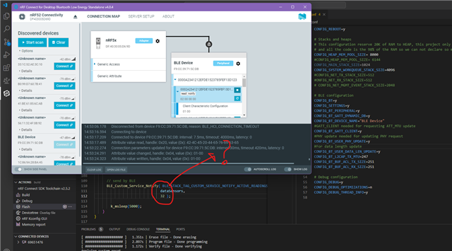

More than 20 bytes through BLE
Hi, I read others cases obout the problem to send more than 20 bytes trhough BLE and add on my prj.conf the next three lines:

Butr when I try to send more than 20 bytes doesn´t receibe anithing.
Could any say me that other parameters could I chech?
I use nRf52832 SDK: 2.5.0
Thanks in advance.
