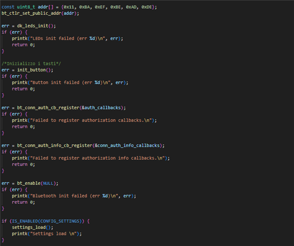

I can change the bluetooth address of the device with the following code:
err = bt_addr_le_from_str(addr_str, type_str, &addr);
if (err) {
	printk("Invalid BT address (err %d)\n", err);
if (addr.type == BT_ADDR_LE_PUBLIC) {
	printk("Using public address\n");
	err = bt_ctlr_set_public_addr(addr.a.val);
	if (err) {
        printk("Failed to set public address (err %d)\n", err);
    } else {
        printk("Public address set successfully\n");
	return;
and this is okay.
I have the problem when I add this part of code:
CONFIG_SETTINGS=y
and
if (IS_ENABLED(CONFIG_SETTINGS)) {
	settings_load();
	printk("Settings load \n");
With this part of code I can not set my bluetooth address. The bluetooth address of the the device is not the one that I have setted but is the one inside the chip (i think).
I need to add settings_load() to keep the bond device information after the power off.
How can avoid this??
Thanks in advance.

    I'm not sure what you're trying to achieve. Are you looking to set a random static address or a public address? In the last code snippet you posted, it seems you're trying to set a random static type and have the stack generate the IRK for you. However, as noted in the API documentation, the stack cannot generate the IRK before bt_enable(). To avoid this, you can specify and pass an IRK to this function yourself.
