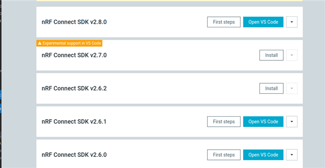

  • Hi Alseth
    is there any possible to connect virtually so that i can show you configuration and remaining issues which i was facing while building overlay-zperf.
    when i was trying to build facing lot of issues, like device is going into scanning state, sometimes only 2.4GHZ is enabling, interface is getting down etc..

    You are running an older version of NCS. Have you tested any newer versions and observe the same issue? For instance v2.6.2 / v2.5.3 or v2.7.0?
    Håkon
    Jaswanth Rajigiri said:
    I was trying in  updated versions
    Did you manage to run the wifi/shell sample successfully with v2.8.0?
    Håkon
  • Did you manage to run the wifi/shell sample successfully with v2.8.0?
    when ever i was trying to create application like sample application, i was facing issues like client is continuously sending like scanning, 5GHz is not showing and wifi commands not working etc.
