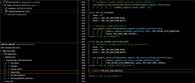

    So I tried to put both (app and mcuboot_secondary) in tfm_nonsecure region (I read the response in email and did not see the edited comment there). As for a surprise, the app was able to download and update firmware! Why mcuboot_secondary slot shouldn't be placed in tfm_nonsecure region and why it works if it shouldn't be there?
    I also check if the code was greyed out as you asked. In editor it did not seem to be greyed out but I also tried to launch the debugger and step over these instructions and they were not executed. Also I have not seen greyed out code in VS code at all so I believe this feature is not really working correctly on my machine.

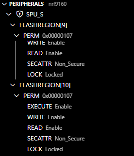

    By the looks the security attribute for the region is correctly set, but the update still fails
     So the problem is kind of fixed when app and mcuboot_secondary is placed in tfm_nonsecure region. Can I leave it like this or this setup might introduce some bugs later on? If this is not the correct setup let me know how else I can help you with debugging this issue

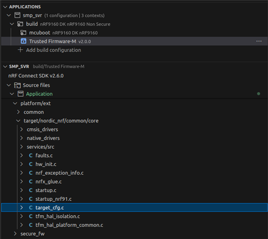

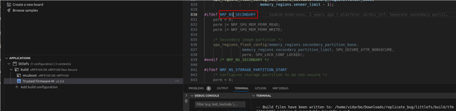

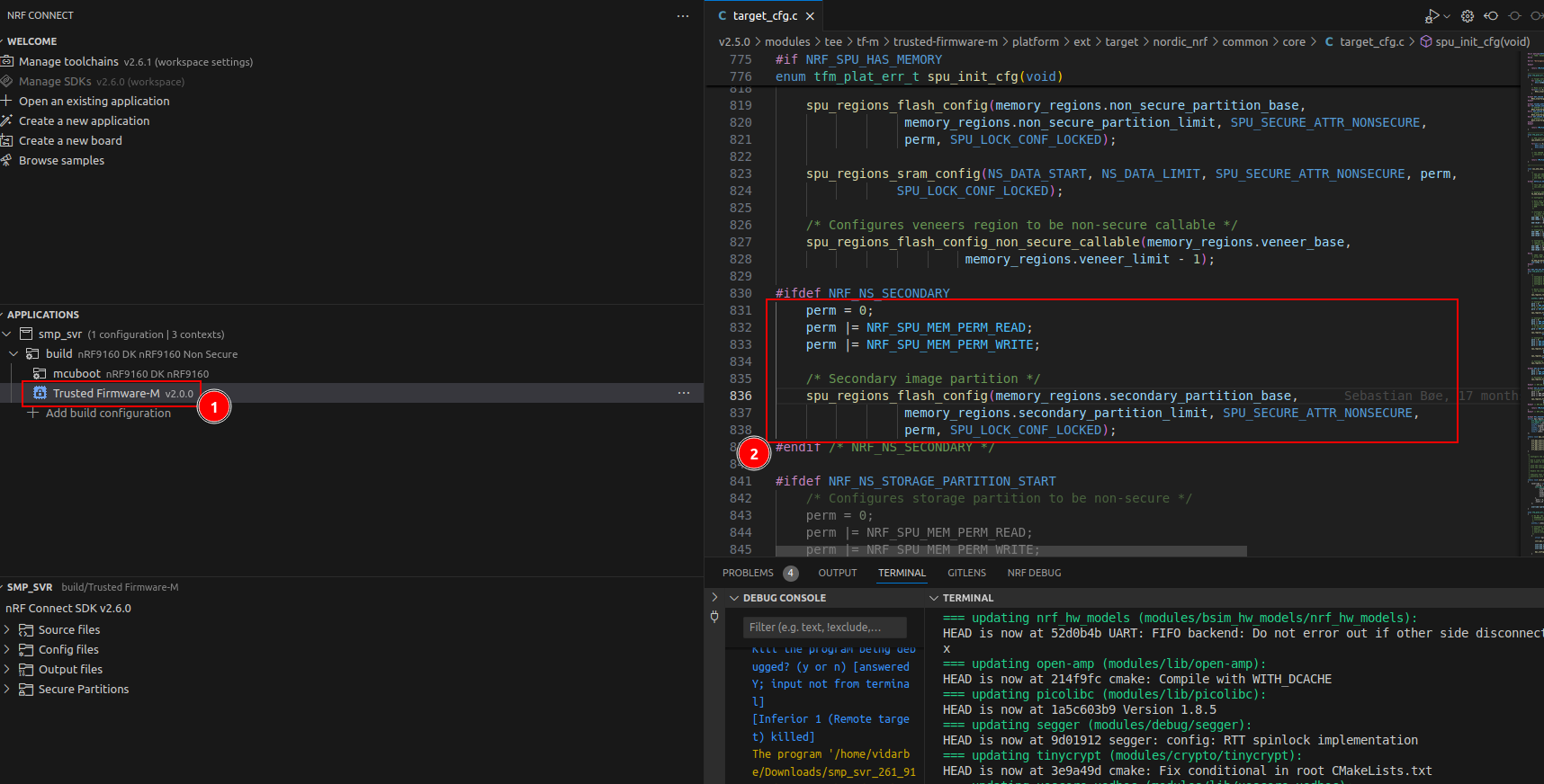

  • Hi Andris,
    I think it would be good if we could understand the root cause for why it failed in the first place so we don't risk masking others problem in the configuration.
    Did you select TF-M as the active build context before you browsed the file?
    It is more that it should not have been necessary. I was not able to reproduce the issue here when I tried to replicate your memory layout.
    Please check region 10 instead of 15. Region 10 starts at address 0x80000, same as your secondary slot.
    Yes I did select TF-M as active build context before opening the file
    Also region 10 is non_secure right before flash_img_buffered_write
