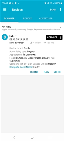

I've changed the UUIDs of what I'm trying to connect to, to be those of a different device that has BLE in it.
I've previously connected to this using an RPi and its UART, getting data in and out of it. So I went PC UART <-> Rpi BLE <-> Other Unit
Am trying to repeat that but using the 52840 DK

Can you think of any reason why it would connect to the DK running peripheral_unit and not this other unit? The other unit has an older chip in, using SES and has   the same types od read/write characteristics.
I would expect it to simply connect to the unit because the service UUID matches, even if the BLE data might not get to/from at first due to some other bug in the code. I'm nevere getting the call to function:
static void connected(struct bt_conn *conn, uint8_t conn_err)
Which I do if I try to connect to peripheral_uart.
