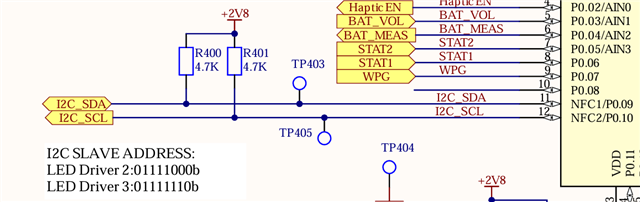

NCS SDK 2.7.0 uses I2C(SCL P0.10, SDA P0.09 ) failed
1. dts config file, I2C_SDA is configed GPIO P0.09/NFC1I2C_SCL is configed GPIO P0.10/NFC1, months ago, I'm using the old SDK, I also found that these pins configed as I2C function can not work, now the NCS SDK has the same problem, Could you help to check why?

  • I got same error, below is the schematic about I2C, It's

    Another project, I uses P0.07 & P0.08, I2C works properly

    I see. If you use the exact same configuration that worked on another board just with different pins, that should work here as well not that you have configures the NFC pins to function as GPIOs.. Can you measure the SDA and SCL lines with a logic analyzer so that we see the signals (if there is any clock and data, and if so, what it looks like)?
