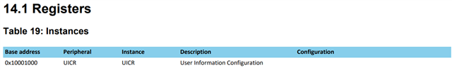

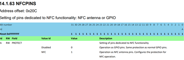

  • Read the PS. Those pins need to be configured in UICR in order to allow them to work as GPIOs.
  • I uses below commands to set NFCPINS to gpio, but I still got the I2C write exception, Any other things need to configure?
    > nrfjprog --memrd 0x1000120C
    0x1000120C: FFFFFFFF                              |....|
    > nrfjprog --memwr 0x4001E504 --val 1
    Parsing parameters.
    Writing.
    > nrfjprog --memwr 0x1000120C --val 0
    Parsing parameters.
    Writing.
    > nrfjprog --reset
    Applying system reset.
    Run.
    0x1000120C: 00000000                              |....|
    To use the NFCT pins as GPIO's without needing additional steps you can add this to  your board files or an overlay file:
    	  &uicr {
    	      nfct-pins-as-gpios;
