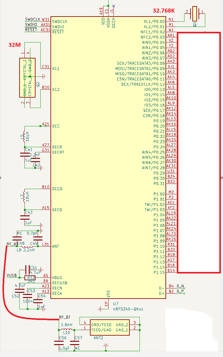

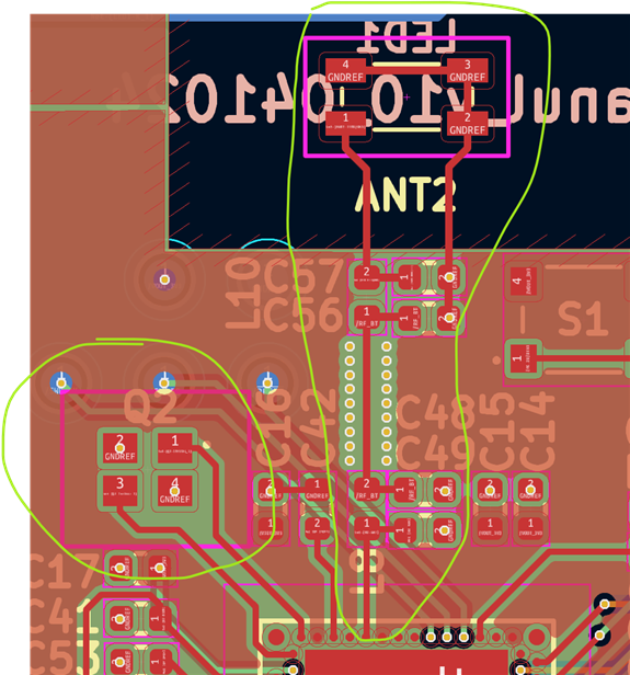

Hi Community,
I made a custom board based on thingy53.
the custom board can be flashed with nRF5340-DK, I see the "merged_domains.hex" is flashed.
Also tried with nRF connect for desktop to flash the "dfu_application.zip", the result is the same.
the appliaction seems no problem, the output from the console looks same as on Thingy53:

As you can see "Advertising successfully started" , that means no issue for this function in main:
err = bt_le_adv_start(BT_LE_ADV_CONN, ad, ARRAY_SIZE(ad), sd, ARRAY_SIZE(sd));
    if (err) {
        LOG_ERR("Advertising failed to start (err %d)\n", err);
        return err;

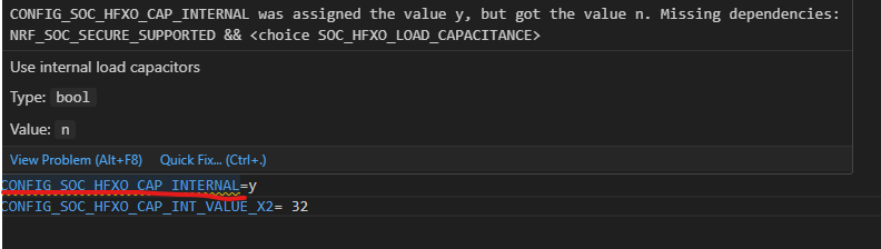

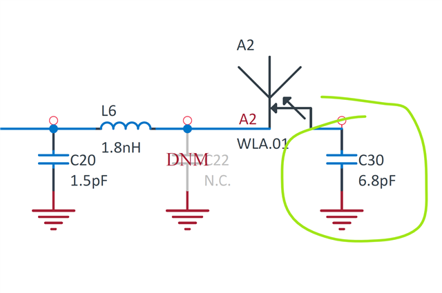

the problem is I can not find the bluetooth advertisement with mobile phone. how can I verify if the network core works correctly? or any other idea?
