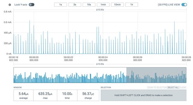

I bought newly announced NRF54L15-DK board. Its version is v0.9.1. I am using NCS v2.8.0. I tried to test sleep current via nrf52840-dk and nrf54l15-dk. When I compile my sleep_test project for nrf52840-dk, I am getting following result with 3V supply voltage.
The result seems okay to me for nrf52840-dk. However, if I use 3V supply voltage for nrf54l15-dk, I am getting following strange sleep average current.

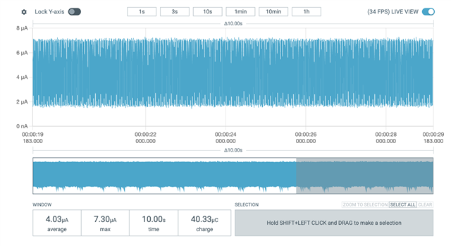

After that, I tried to use 2.5V supply voltage with nrf54l15-dk and I got following idle current results. Strangely, I am seeing current spikes at every 4 seconds.
I watched Nordic's demo on YouTube and I feel there is no this type of ticks on this demo. I wanna learn that how can I use 3V supply voltage and How can I solve this sleep issue?
