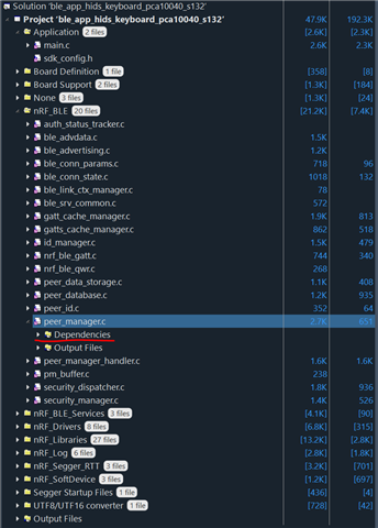

  • Ok, I started with that example. So far, I tweaked the peer_manager_init function. This seems to disable access Windows 10 connecting with the devkit, but connect with the phone, which is what I need. Now I want to integrate that function in my project and add peer_manager.c with its' dependencies. I'm stuck on that part with Segger. How do I add that with the dependencies? I have peer_manager.c in the components folder of the project.

  • Ok, so it seems I fixed it somehow. I had issues with importing files in the SEGGER Embedded Studio with dependencies. It seems that if you don't include the headers that are connected to peer_manager.c (or other files that you might use) in the main.c file, it won't show the dependencies as imported. Also clean & build seems to fix it. Had to manually adjust some things in the component folder due to issues with the sdk_config file, mainly in the IF part because the sdk_config didn't have those definitions to enable/disable them. I imported the peer manager and added the following code, which blocks peering with PC Windows 10 devices.
