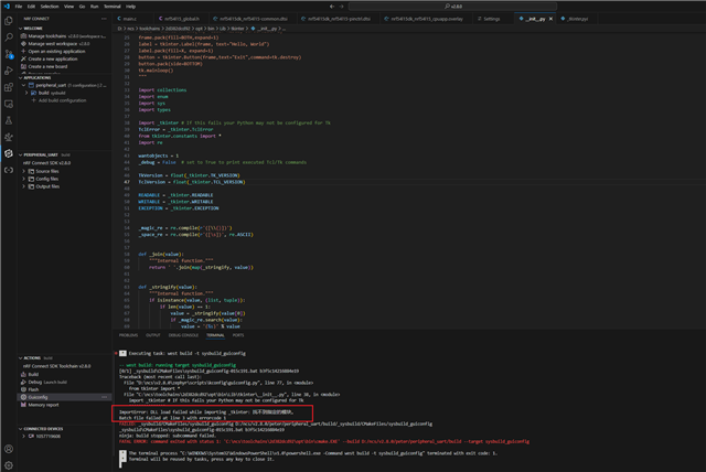

1. Seems to be a bug, how to fix this error.
2. Repeat example: ncs\v2.8.0\nrf\samples\bluetooth\peripheral_uart
Thank you for all your assistance.
Peter.Min
Peter.Min

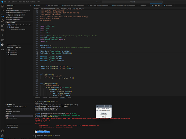

Hi Peter,
The dependencies for GUI config is not part of the toolchain manager. Is it deliberate that you are using Guiconfig? If not, I recomend you use nRF Kconfig GUI which is within VS Code. You can set this as default by searching for nrf-connect.kconfig.interface in the VS Code settins and selecting it. You can also launch it even if it is not the default by clicking the three dots to the right of nRF Kconfig GUI in the actions tab, and selecting nRF Kconfig GUI from there.
Br,
Einar
Hi Einar Thorsrud,
1. Just to test the Guiconfig.
2. Everything else can be used.
Peter.Min
Hi Peter,
I see. I recomend you use nRF Kconfig GUI then, but I have forwarded this internally.
Br,
Einar
