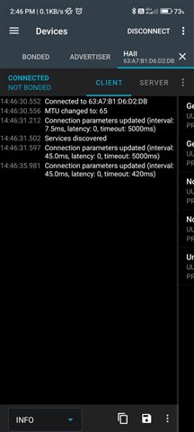

How to increase the MTU size in NRF52833?
I have tried the below in proj.conf.iam using NRF52833 DK in VS CODE(NRF SDK Connect extension.Iam trying to receive data through gatt protocol,but it is not receiving more than 20 bytes.
toolchain version 2.8
also my build log showing ...
Memory region         Used Size  Region Size  %age Used
           FLASH:      203344 B       248 KB     80.07%
             RAM:       29188 B        32 KB     89.07%
        IDT_LIST:          0 GB        32 KB      0.00%
according to datasheet..512 KB Flash + 128 KB RAM for NRF52833DK.but the build log showing only 32kB of RAM,248kB of Flash.why?
CONFIG_BT_USER_DATA_LEN_UPDATE=y
CONFIG_BT_L2CAP_TX_MTU=247
CONFIG_BT_BUF_ACL_TX_SIZE=251
CONFIG_BT_BUF_ACL_RX_SIZE=251

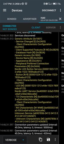

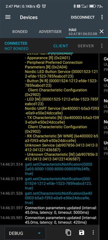

  • Are you able to upload the verbose/debug log from the phone here so we can review it?
    Did you try increasing some of the stack sizes in your configs on your end? Specifically the ones below:
    CONFIG_BT_RX_STACK_SIZE=1024
    CONFIG_BT_HCI_TX_STACK_SIZE_WITH_PROMPT=y
    CONFIG_BT_HCI_TX_STACK_SIZE=640
    CONFIG_MAIN_STACK_SIZE=1024
