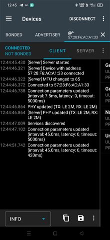

I have tried the below in proj.conf.iam using NRF52833 DK in VS CODE(NRF SDK Connect extension.Iam trying to receive data through gatt protocol,but it is not receiving more than 20 bytes.
toolchain version 2.8
also my build log showing ...
Memory region Used Size Region Size %age Used
FLASH: 203344 B 248 KB 80.07%
RAM: 29188 B 32 KB 89.07%
IDT_LIST: 0 GB 32 KB 0.00%
according to datasheet..512 KB Flash + 128 KB RAM for NRF52833DK.but the build log showing only 32kB of RAM,248kB of Flash.why?
i tried in 3 different phones but it still the same size
