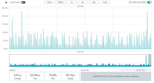

  • I tested the system_off example, without retention (the basic case) and I'm getting current consumption at the level of almost 4uA. This is the current chart:
    I see it has GRTC enabled, and I suspect this is it.
    The power consumption is actually part of the topic because I'm a bit concerned that the GRTC running is consuming more current than the whole nrf52 project with advertising running. And I'm aiming for the lowest consumption possible.
    Is there a way to run zephyr, with BLE advertising, without GRTC enabled?
  • What you were seeing when you have BLE activity is most likely the device in System ON Idle between the radio events. The expected current of System ON Idle with full RAM retention is 3uA. In this state, as you are running a RTOS, you need the RTOS system clock, and thus either GRTC or RTC has to be on. GRTC is good for this purpose.
    The System OFF sample demonstrate the System OFF state. That is a deeper state of sleep. 4uA is quite high for this. If you want to explore this mode further, make sure you have turned off all peripherals, and turn off RAM retention. Also, your application restart when it wakes up from this state.
