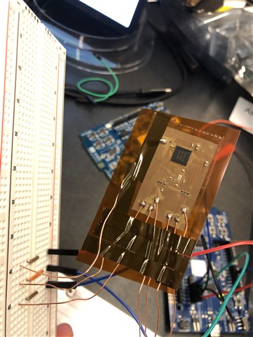

For my project I am making a custom circuit board which is pretty much just the nRF52832 chip and the surrounding capacitors and whatnot. I'd like to program this circuit board using my nRFdk, but am unsure how to do it. I actually have two of the dk circuit boards, and I was trying to use one to program the other to test the process before trying it on my custom circuit board. However, I was running into some issues.
I suppose my question is this: How can I program my custom board using the development kit I already have?
I've seen other posts where people were able to program and external board using a dk, but many of these weren't resolved. Additionally, the ones that I saw were resolved seemed to have a key difference when compared to my situation, such as using the 9 pin connector debug in to program an external board (my custom board doesn't have this, only the connections directly to the nRF52832. Happy to provide more information, so let me know if that is needed. Additionally, if it isn't possible to program my custom board this way it would be good to know.

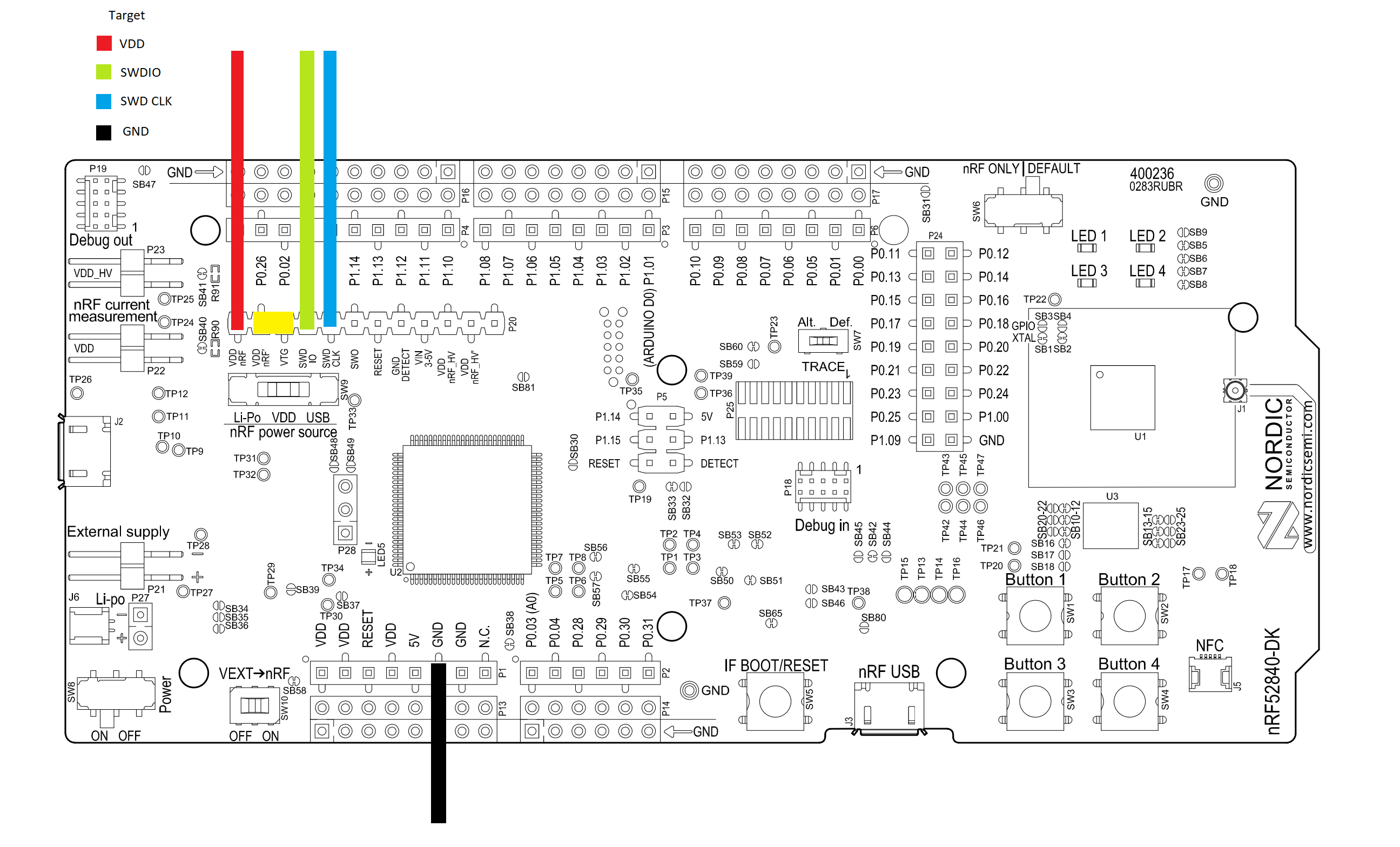

  • Okay, lets completely forget about programming my other dk. All I want to do is program a custom, external board, shown here
    On this external board, which is mostly just the nRF52832 chip, I have access to Vdd, ground, swdio, and swdclk. My current connections are as follows:
    nRFDK     /    Custom
    Gnd         -->   Gnd
    Vdd nrF   -->   Vdd
    SWDIO    -->   SWDIO
    SWDCLK -->   SWDCLK
    Also, I have connected Vdd to Vtg on the nrfdk debug out pins. The schematic should match the one shown here, which seemed to work for someone else.
    My custom board is not powered, and the dk I am using as a programmer is connected via the USBC to my laptop and is getting power through that. When I go to flash my code in VSCODE, I get the following error:
    [error] [ Client] - Encountered error -102: Command read_device_info executed for 139 milliseconds with result -102
    [error] [ Worker] - An unknown error.
    [error] [ Client] - Encountered error -102: Command read_memory_descriptors executed for 28 milliseconds with result -102
    Failed to read device memories.
    I currently don't have access to the reset pin on my custom board, because I didn't think it was needed to program it. However, the image in this discussion post https://docs.nordicsemi.com/bundle/ug_nrf52832_dk/page/UG/dk/ext_programming_support_P20.html
    seems to show that the reset pin is required.
    Is the schematic in the link the correct way to connect an external board and program it, or is my issue somewhere else? Any clarification would be greatly appreciated.
