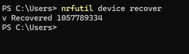

  • Hi Jamie,
    There's been some similar experiences both internal and external on this behaviour and we are investigating. Assumption is that there's some part of the support for the nRF54L15 that conflicts with programming other devices in some situations. However, the way out is to open a powershell or terminal and run "nrfutil device recover"
    After that, you should be able to use your device again as normal. We are working on finding the cause and updating the SW deliveries from us.
    Best regards
    Asbjørn

  • Hi Jamie,
    I'm glad you found a way around and that you have a working setup. We will hopefully see less of this, but great to have a reference for others.
    Thank you
    Asbjørn
