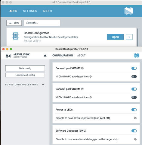

  • I had a similar issue on my board.
    It turns out the Software Debugger was disabled on my board. I used Board Configurator to enable SWD and it fixed the issue for me.
