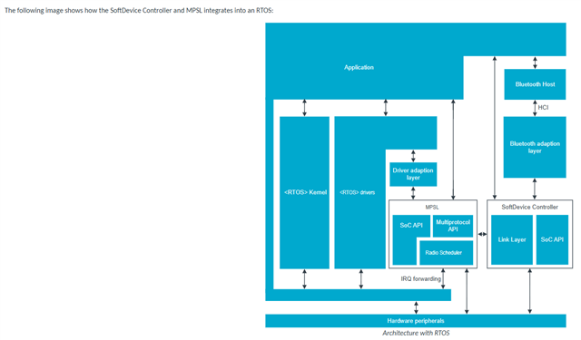

The graphic below seems to imply that the SoftDevice is controlling the Link Layer, so is it always included in my builds even if I don't explicitly specify it?
    Yes. The SoftDevice controller is the default Bluetooth controller on all nRF devices, so when you build a project that include the Bluetooth stack it will include the SoftDevice controller unless you specifically opt to use the Zephyr LL (which you should not).
