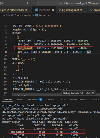

  • Hi   : How did  you place a variable to the app_noinit section ?
    I add 4K app_noinit memory, but in the final Linker.cmd, it just add app_noinit into the MEMORY, so I can not use
    "int test __attribute__((section(".app_noinit"))); " to place the variable test to the app_noinit memory.
