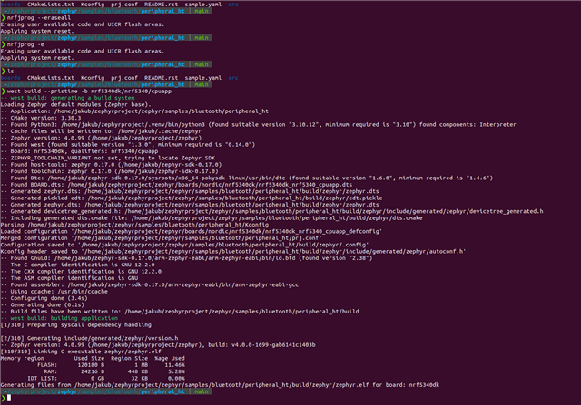

I am building a sample using a west command:
west build --pristine -b nrf5340dk/nrf5340/cpuapp
or
west build -b nrf5340dk/nrf5340/cpuapp
or
west build --pristine --sysbuild -b nrf5340dk/nrf5340/cpuapp
and flashing using:
west flash
or
west flash --recover

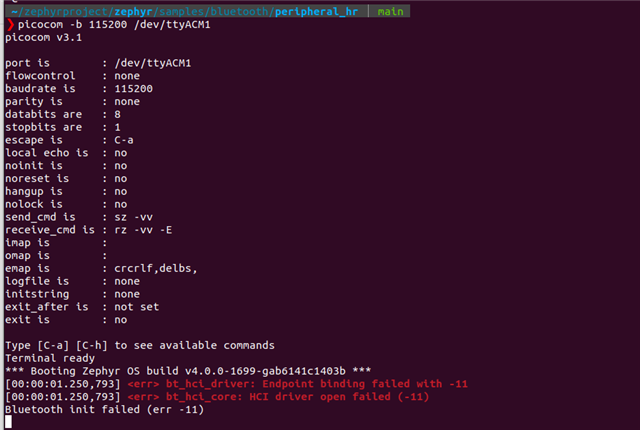

As a result, I have the following error during the boot-up:
*** Booting Zephyr OS build v4.0.0-1699-gab6141c1403b ***
[00:00:00.276,672] <wrn> bt_hci_core: opcode 0x0c33 status 0x12
Bluetooth init failed (err -22)
Please let me know what I am doing wrong.

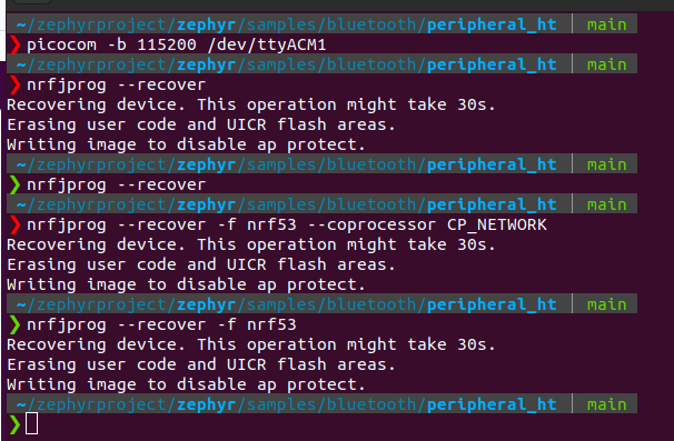

    Can you try to recover the device using nrfjprog --recover before flashing? You can also try to run the peripheral_hr sample using hex file from nrfjrpog
    Thanks.
    BR
    Kazi
    It didn't help.
    Here are my recovery steps:

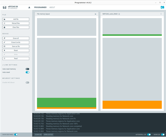

    Next, I am flashing it using the NRF Connect For Desktop (just in case)
    It is the memory map after flashing the peripheral_ht example:
    It is the nrf connect log:

    All the time I have an error with the BLE initialization.
    I have tried on NCS v2.8.0. It works here. Can you try to run the samples on NCS v2.8.0?
