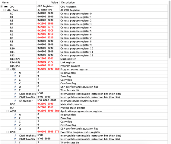

  • After insvestigation, it appear that a call to a settings_save_one() function just after the ble stop break the execution without explicite exception and reset cause 0x12 HARDWARE_RESET.
    After disabling watchdog, the same problem reset with cause 0x10 BROWN_OUT.
    Finally i manage to avoid the crash by moving the settings_save_one() call before the ble stop...
    but i still do not know what's exactly going on...
    i did not found any irq conflict and tried a lot a configuration variation about it...
    same behaviour with all others sensors disabled and uninitilaized... maybe dts.?
    i didn't try on DK for now...

    settings_save_one() call is in my app and was called after the bt_le_adv_stop(). but debugger stop in bt_le_adv_stop() ????
    moving settings_save_one() call before the bt_le_adv_stop() solve the crash !!
