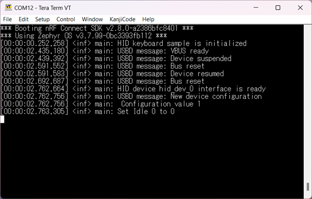

  • I guess I should redo the test, I might have missed something, and I did use the nRF5340-DK (not the nRF7002-DK). But you can confirm you physically removed the USB cable from the nRF USB port, and re-inserted it after programming?
    Kenneth
