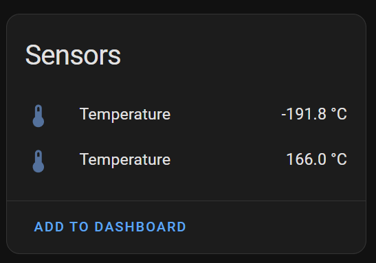

However, I noticed a separate issue, which I feel is caused by this hack.
When I add my sensor to Home Assistant, the two temperature measurements appear like this:
However, when I change the device (using a potentiometer to adjust the ADC input), only one of the values (the first) actually changes. Both ADC pins get the same voltage, so the Home Assistant values should *both* change.
If I "Read" the endpoint cluster directly, the value returned is correct.
I believe the hack is impacting the attribute reporting.
Do you have any idea how I can successfully declare two endpoints with Temperature clusters?
