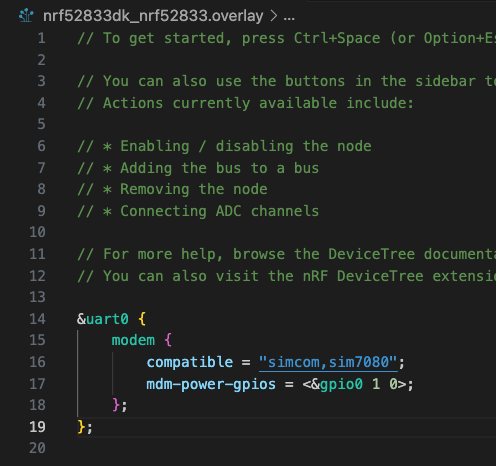

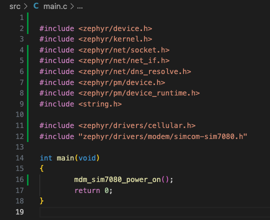

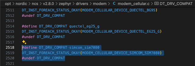

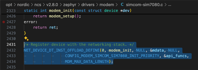

I am encountering the following error while trying to compile the Zephyr modem driver for the SIM7080 module:
/opt/nordic/ncs/toolchains/15b490767d/opt/zephyr-sdk/arm-zephyr-eabi/bin/../lib/gcc/arm-zephyr-eabi/12.2.0/../../../../arm-zephyr-eabi/bin/ld.bfd: zephyr/drivers/modem/libdrivers__modem.a(modem_cellular.c.obj):/opt/nordic/ncs/v2.8.0/zephyr/drivers/modem/modem_cellular.c:2519: multiple definition of `__device_dts_ord_114'; zephyr/drivers/modem/libdrivers__modem.a(simcom-sim7080.c.obj):/opt/nordic/ncs/v2.8.0/zephyr/drivers/modem/simcom-sim7080.c:2432: first defined here

This error occurs due to definition conflicts for the same device tree item. The conflicts are caused by the following two macros:
my main.c file
board overlay file

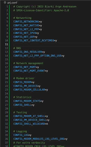

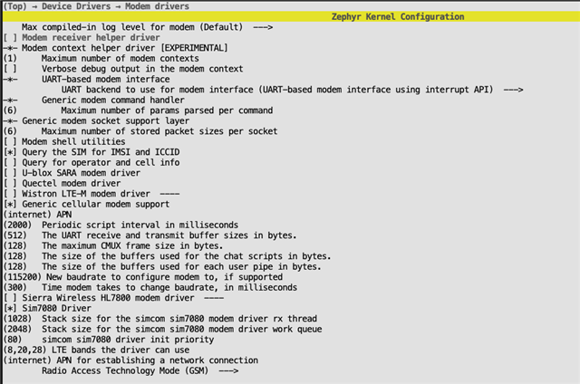

Project configurations
Zephyr kernel configs related to the module
