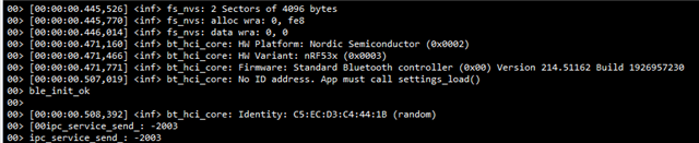

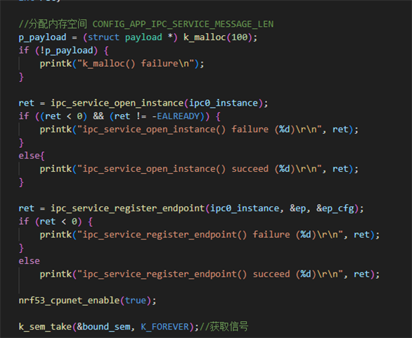

The IPC and bt_enable are turned on at the same time, and the chip is not working
If I initialize the IPC and then turn on the bt_enable, it will lead to the status quo in Figure 2, what is the reason?
If I block k_sem_take (&bound_sem, K_FOREVER) and the application core binds the network core unsuccessfully, the ipc sends back -2003, and the Bluetooth initialization can be enabled

Here's my config

  • No, it is possible to establish communication channel between the app and netcore regardless of whether you are running a split stack or full stack configuration. You can run the full Bluetooth stack on the network core, but as mentioned earlier, this configuration is not supported for production. Also, depending on your requirements, it may also be difficult to get everything to fit on the network core due to the memory constraints.
    I recommend using the well tested and proven split Controller and Host configuration and run your algorithm toghether with the Bluetooth host on the application core, unless there are technical reasons making this impossible.
