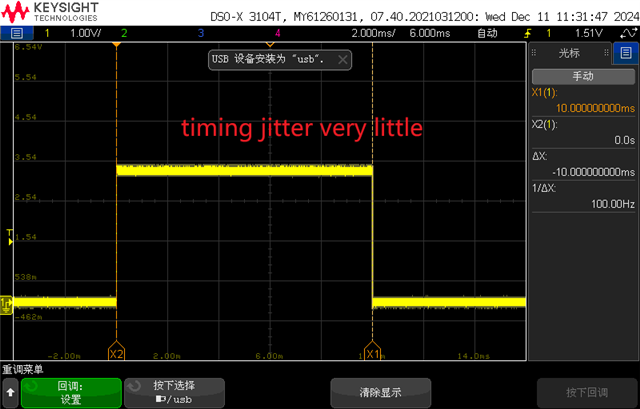

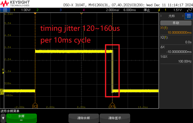

2.test data
test result as follows:
picture A,show timer2 timing jitter test on NRF5-SDK17.1 ble-softdevice
picture A
picture B ,show timer2 timing jitter test on NRF5-SDK17.1/examples/peripheral/timer demo
picture B
3.question
Why timer2 timing jitter of ble_softdevice is more large than peripheral-timer demo?
