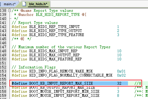

At present, there is no routine found on the Internet about NRF52832 Bluetooth sending more than 6 characters(NKRO)
I used nRF5_SDK_17.1.0,The following is the modified report_map_data[] and BOOT_KB_INPUT_REPORT_MAX_SIZE,But never made It.

  • Hi Zbxiong,
    Could you let me know what exactly happen when you try to test ?
    There is a related ticket you can find here: Encountered a problem sending more than 6 bytes of data using the hid service
    The last reply pointed to this https://learn.adafruit.com/custom-hid-devices-in-circuitpython/n-key-rollover-nkro-hid-device
    Could you take a look at the page to see the report there and check if you can use that in your project ?
    We have quite limited experience with NKRO here.
