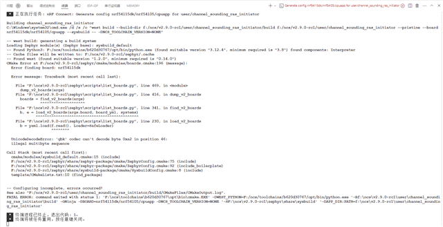

1. As shown in the following figure, how to resolve such a default instance compilation error?
2. I have used west update to confirm that ncs v2.9.0-rc1 is successful

Hi Peter,
I see you build for nRF54L05 emulation on the nRF54L15 DK. Is that deliberate? If not, I suggest you build for nRF54L15 the "normal" nRF54L15 DK without 05 or 10 emulation (in fact I suggest you do this for now unless you have a strong reason for building for the other nRF54L variants)
Hi Einar Thorsrud,
This issue has been resolved
This issue is an SDK bug
